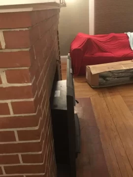

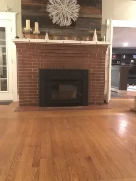

Bought a quadrifire grand voyager insert to replace an ancient insert in a home I bought 3 years ago. When the installer finished the insert, with its surround stick out about 5 inches from being flush. Installer said he would have a steel box made to close the gap. He said no big deal, should take a week or 2. Monday will be 4 weeks. Starting to think about what my options are if the installer falls through. Any help/advice would be appreciated.

That's a pretty big gap. Was this a dealership installer or did you contract him independently? What will be done about the hearth? It's quite short of requirement.
Going to get a hearth pad to address the hearth issue. Installer was recommended by the dealer. Dimensions should have worked, but the back of fireplace sort of A-framed up, preventing the insert from going any further back. Love everything about the insert, but that gap is an eyesore

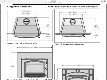

The dimensions that I brought were 31Hx37.5Wx18D. The aspects working against me are that the Grand Voyager exhaust is on the back part of the top and my fireplace is a modern fireplace with the firebrick in the back curved. I was not aware of the curve in the firebrick when I measured. You are right, I will still be off by 2 inches and the whole goal was to have a flush insert.

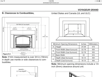

Also, just to add one last piece. The hearth is 18 inches, so a flush install meets the necessary requirements.
It shows you need 18-1/4" so it should fit if the bricks did not slant forward.

The math does not add up, if your saying the insert can go back 3" and you have 5" sticking out then the depth measurement can't be 18". I would measure the side depth again if you can get a tape measure back there just to confirm. I just measured my fireplace and the center is two inches deeper than the sides, maybe you measured in the center and that why your missing two inches.
You are right. I was measuring along the top of the insert, where the bricks begin to arch in. Along the bottom the depth is 18 inches. I feel like the writing is on the wall here that the insert will have to be changed. With such a large investment I just don't think I can look at it sticking out 5 inches everyday.
