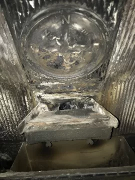

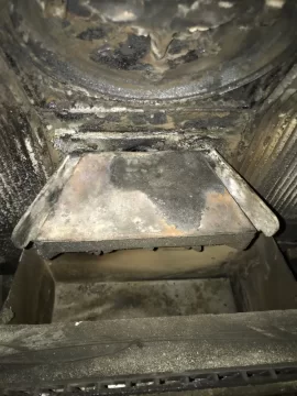

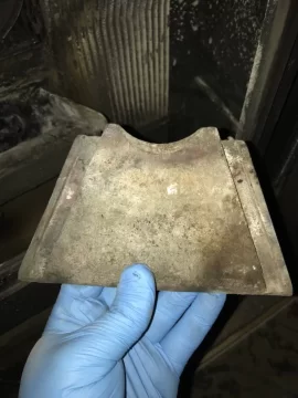

So I gave it another go and it just doesn’t sit right. It has grooves on the underside that look like it should sit on top of the sides on the burn pot but is not long enough to do that. It just loosely sits in the burn pot and kinda gets in the way of the pellets coming from auger. Am I using this wrong? Also is it ok to not use it? Thanks in advance.

Upload a picture of it installed. I've seen them warp, crack, or just wear away, thus poor fit.
Does this seem right?

Thats bad.It is either eroded away,a lot,or wrong,or possibly someone put a different burn pot in stove.You can measure the lip it sits on,and one of us can measure ours.Measure the lip at the back.
