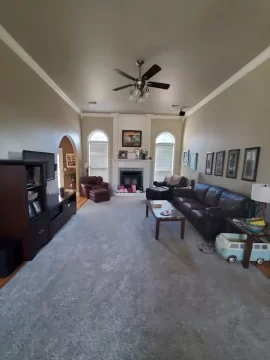

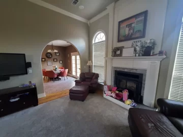

Thank you for the reply. Here are some photos of the layout. Living room is a long room with 13' ceilings. The picture is how the living room opens to the dining room. Behind that red table is the master bedroom, which is the room to be heated. It is a single story, ranch style home. My thought was to run ducting from the ceiling of the living room to the ceiling of the master with thermostatically controlled inline fan. Based on what you are saying this might not work well?

@photoghog that might work, but even an insulated ducted run like that will make the bedroom feel drafty as 100deg air flows out, I while back there was a member that did your idea but in reverse, he made a return in his ceiling with a duct fan boosting the air back to the stove room, as another member stated, cold air leaves and is replaced with warm air.
I installed a duct fan into a floor grate setup this winter, I will say that it worked for my setup, but even a quiet fan is noticeable at night when the rest of the house is quiet. I used a 6" 160cfm fan that was fairly cheap at homedepot.
It would probably help a little but not the way you expect. Whatever the temperature is in the living room, that's the warmest air that would ever be blowing out of the vent in the bedroom. 80-90 degree air doesn't feel that great blowing around it's not like a warm air furnace that can blow 140+ degrees. As @kennyp2339 said it will feel drafty.
Maybe just putting a fan in the bedroom doorway at floor level blowing out into the hallway in the direction of the fireplace would help.
That's where I would start. If it proves effective one could make this more permanent with a ducted blower system on a thermostat. I've described this multiple times in threads on "Moving the heat". Choosing a quiet blower will help if noise is a concern.
