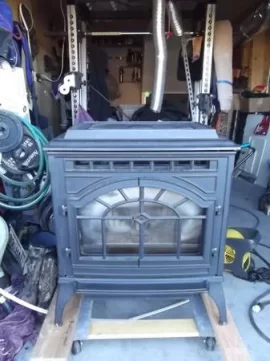

I found a guy a couple hours away selling a 2006 model Mt Vernon. He's asking 2500. First question I have is this a model I should worry about having issues? (picture attached) It's a bit of a drive so I am going to factor that into my offer but honestly what is a fair price for this stove?

Is that the Mt. Vernon AE model or the original Mt. Vernon? I am not sure what year they came out. I have the AE and it should provide heat for your home. It can really throw the heat. The AE had some minor glitches in the beginning that should have been taken care of under warranty on that stove. It kinda looks like that is the AE version, it looks to not have the heat exchanger tubes in it. You should be ok with it. I would ask him if it has the upgraded burn pot and ignitor in it. Also I would probably try to chew him down a little. I believe new they are around $4,500. Good luck.

He didn't say if it was the AE something I will ask. I was thinking of offering him $2000.

That's what I was thinking for price. You could ask him to run it for you too. Make sure all the motors work and the auto clean slides properly. There is a lot of knowledge here, so let us know how it goes and if you would get it and have questions or problems I am sure we can help ya out.

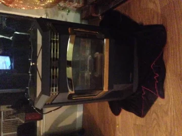

Wow, We need to see some pictures. Now you will have the radiant heat of a wood stove without nearly all the work.
Under $2000 and pretty!
The only thing that would have made the deal sweeter is if had come with a ton of pellets.
