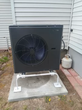

I did this in 2018, switched to Pellet Stove (Harmon XXV). This spring supplemented it with Low Temp Heat Pump (-20f it says it will run, Midea Evox G3). Have yet to burn bag of pellets (3 fires couple hours to warm up living room to 74f).

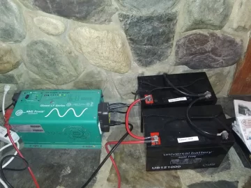

When we put Pellet Stove in we got Inverter/Charger. One 100ah Battery for running when power goes out. Had one 10 hour run without power. 1 Battery was not enough. Got 2nd Battery. Replacing batteries next Season I hope. I keep 1k Clean Power Portable Generator for longer run times. Main 7kw Generator is not clean power we have. Have yet to do more than test both.
Biggest downside with pellets over wood is 40lb bags. In the future if I am 80+ can I lift 40lb bags? They do come in 20lb bags at least. Will cross that bridge then.
So far this Very Warm Season Heat Pump is doing great. I sense it struggles below 9f more than 30f. Kw used so far at worse is 200kw. But we have 5kw Shop Heaters. 2 in Shop (See pic it's on right, one on left out of pic), 1 in Garage and 1 in Old Shop (Part of Garage but door to it). Plus 2 Refridgerator and Two 20cf Upright Freezers.
Did test turning off all the Shop Heaters when it was 30f at night. 9kw is best estimate the Heat Pump used.

Inverter AIMS 1250
