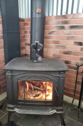

Hello all,
I'd appreciate some help on this topic and I apologize if it's been asked before, but I see all kinds of posts about people packing the stove full and am kind of confused or maybe just paranoid. Does more wood mean a hotter stove? I'm asking because when I load just 4 or 5 pieces into my stove it runs at about 600-700 according to my probe thermometer. The problem is I have to reload the darn thing so often. I have a Napoleon 1100c and am already limited as to how much I can put into the stove as it is. Looking back I should have opted for the larger 1400 model because it takes nothing to fill this little fire box. I went with the installer suggestion, but I don't think they took into account my old drafty house. With all that aside, If I put more wood into my stove and control the air down like I normally do, will it still maintain the same temperature or will it run hotter? I haven't gotten the new stove jitters totally out of my system yet as I've only been burning for a couple years now. My gf thinks I'm a nut because I will sit there staring at the stove to try and see when the secondaries fire and try to figure when is the best time to close the air down. I have 1yr+ seasoned ash, maple and cherry, live a fairly windy area (open field) so I'm always a bit nervous about controlling the air. Any and all feedback is appreciated. Thanks folks.

It's a double wall pipe. I usually start turning it down once the wood can maintain flames without beinf choked out. Loading it up full just makes me nervous with how the temp is with just 4 pieces in there

Great, I thought that looked like double-wall with a probe thermometer. It sounds like you are doing ok. If you load the stove with thicker splits, packed tightly using thinner splits to fill the gaps, then the fire will burn slower. Start turning down the air by the flue temp. I don't know precisely how your stove will behave, but with our stove that is when the flue temp is in the 500-600º range, but with a digital probe that responds much more quickly than an analog probe.
