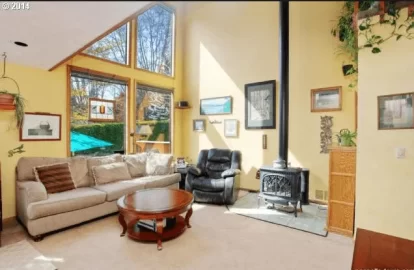

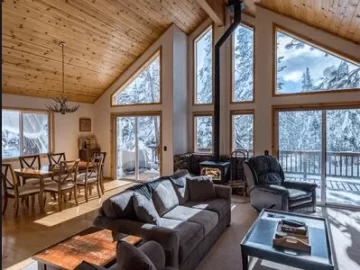

To minimize the stark black pipe look you could add a darker color brick or other covering behind the stovepipe to reduce the contrast. Here's some random finds from a google image search:
[Hearth.com] Newbie to wood stoves and trying to find some answers about pipes. [Hearth.com] Newbie to wood stoves and trying to find some answers about pipes. [Hearth.com] Newbie to wood stoves and trying to find some answers about pipes.

The other option is like the one depicted in the pictures where you leave the ceiling support box up at the top of your vaulted ceiling, but just spaced out enough from the end wall to meet stove pipe clearances. Would still have the stove near the wall, but you would have a long section of black pipe from the stove up to the transition to the double wall up in the ceiling since it is vaulted. Some folks like that look, others don't.
