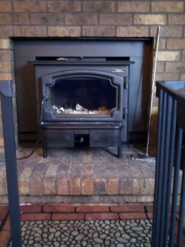

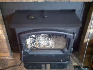

I just installed a Lopi Revere, and I have to say I love the stove so far as I learn how to properly start and
maintain a fire. I have developed a few questions I was hoping I could get answered.

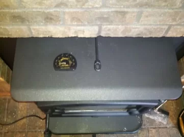

I have one of those cheapo Rutland bimetal magnetic thermometers and I placed it directly on the cooktop
of my Revere.
1. ) Is this the right place to put the thermometer?
2.) What temperatures should I be looking for?

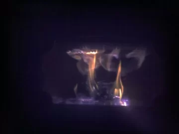

The night before I burned I know was a year older and drier, but the temperature ran lower but I think I had a good secondary burn
even though the theremometer read closer to 450. I would prefer more heat output though. I have a pic of the flames from the
previous night.
3.) Is this a case of reading a higher temperature because the thermometer was in the wrong place?
4.) Did I allmost overfire my stove?
5.) What temperature is an overfire for this stove? and where is that temperature read from?

Welcome to the forum Voodooschild.
Your thermometer is probably placed close to the ideal. I'd just slide it a bit more towards center and as far back as you can. Temperatures for your stove should be anywhere from 500-650 tops. 400 and more gives you a good flue temperature to help keep creosote at bay a bit.

That picture of the fire is pretty.

3. Probably not.
4. Probably but I would not be overly concerned just yet. If worried, give the stove a thorough check for any cracks or warpage.
5. Check your stove manual.
