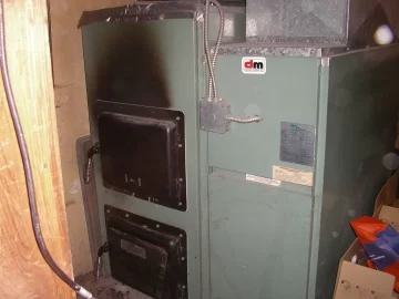

I just purchased a new home that has a Newmack combination furnace (oil, wood,coal) from 1978. The previous owner heated the house partially with coal and wood. I became very excited one day and decided to try to use it with wood. After watching many videos on youtube, I decided to give it a try. I turned up the woodburning dial to start the fan, opened the air blower to the middle setting. I also opened the vent at the bottom to allow more air to flow in. I loaded the chamber with wood little by little as the fire started. Everything was great but I noticed that in some rooms of the house, there was a smell of smoke. Alarmed I placed the CO2 detector in these areas to ensure that the levels were OK and the alarm never was set. Yet, I am not certain if there should be smell in the house when using a woodburning furnace. Is this ussual? Does anyone have any suggestions? Any videos or books or websites that I should be viewing? Please help!

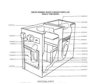

Smoke smell could come from lots of places. Part of the furnace pipe and heat exchanger goes through the return air inlet - as in the drawing below. If that has a slight leak in it or even a tiny bit of creosote leaking (the size of a fingernail could smell a lot), then you will get a smell in the house. If the return air is pulled from the basement - and some smoke spills when you load, the same thing could happen. Make sure the stovepipe is very tightly connected and cemented where first contacts the furnace.
