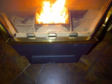

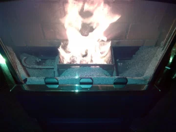

Is the ash very light in color and fluffy? Some pellets have that fluffy type ash that blows up easily and ends up everywhere. If your not getting a buildup in the pot, have a bright active flame and getting good heat output I wouldn't be too concerned to be honest. Try a bag or two of a different brand pellet and see if it is the same. Just remember, every brand pellet, and many times different batch of the same brand, might require you to fine tune your air/ feed.

Good idea, I'll get a few bags from another brand next time see if it makes a difference. And yes it does appear to be light and fluffy, took some pics yesterday, this is after 24 hour burn on low. Sorry pics aren't great.

I wouldn't be super concerned. When I have been burning at lower setting for a while, I like to burn at a higher setting for a half hour or so. Try a different brand and report back.

Know nothing about your stove, but my old Whitfield Quest puts most of the ash in the firebox and almost none in the ash pan, requiring vacuum every 1-3 days depending on pellet I'm burning. I might get a bit longer with an extremely low ash pellet, but some stoves are designed so that most of the ash never has a chance to drop down into the ash pan because the air flow doesn't allow it. Normal for those stoves.

Yup, I found that online after I first started having issues with overflowing burn pot. I open the damper when I first start it or else pellets go flying everywhere. Once the fire is properly started I leave them open only about 1/8th of an inch, that seems to keep my burn pot fairly low, but ashes fly everywhere. You can see those dampers on the floor of the stove each side of the burn pot in the picture I posted.
I think you might be right, just a design thing, nothing can be done. Which is fine, as long as it's safe, that was my main concern hehe.
