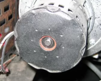

Well, the comb. blower motor has "sealed" ball bearings, but you can sneak some oil into the outer one pretty easily. The inner one can be oiled if the motor is removed from the stove and also removed from the holder, but it's tough. If you look at the bearing on your motor, like in the pic, and turn the shaft, you'll see the bearing race turn with the motor shaft....just on it's outer edge is where you can try to get some oil in. Same for the inner, if you decide to dismantle the blower/mount.
Also, there have been members that have bought replacement bearings and replaced them.
