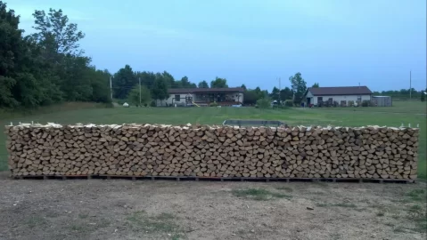

[Hearth.com] noodling oak [Hearth.com] noodling oak
that is a beautiful scene...love the stacks...as for the cutting to the right i had the same problem until i relaxed the grip a bit and let the saw do the work
