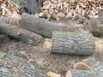

Hello Everyone,
Hope all is well. I was lucky enough to receive three large truck loads of firewood over the past few months. It's mostly oak. I've been wanting to make some shelves and I was considering cutting boards out of some of these logs that I have left. I figure if I screw it up, it will simply end up in the stove.
Question - has anyone used a chainsaw mill and do you have suggestions on what to buy ? I see portable mills on Amazon for about $150 but no idea if they're good. I'm not going to be doing long boards - I'm thinking 48" tops.
Next question, I have an MS360 - if I buy the right chain, will this saw be capable of doing to cuts ?
Appreciate any thoughts or suggestions. Thank you

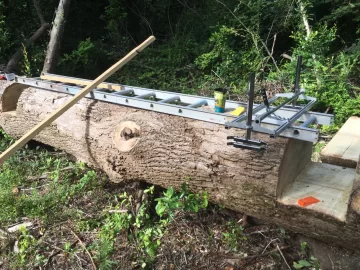

Question if anyone has time. For the initial cut, can I simply secure a 2x6 or 2x8 to the log as the guide? I would obviously level it and make certain the depth of the cut will be below the fasteners . I see a lot of people building frames or using aluminum ladders - I was wondering if this would be an easier solution. Thank yo

I've done both. If you go with the plank grab a package of wood shims to stabilize the plank along it's length to dampen vibration. If you just wanna give it a go just use some sticks and crap to help stabilize it .
The upside to a board is you can sink screws through it into the log. A ladder you need to be a little more creative to attach it but is more stable.

Look at your heart cracks on the ends to help set up with. If you can get your main crack swallowed inside your cut, the vertical crack running down in the pic, (crack running inside the board parallel to the board face) you can slow down how far they run as things dry. If they are running in the board across (if you cut in the pic with your bar horizontal) they will open up longer as the board fries.

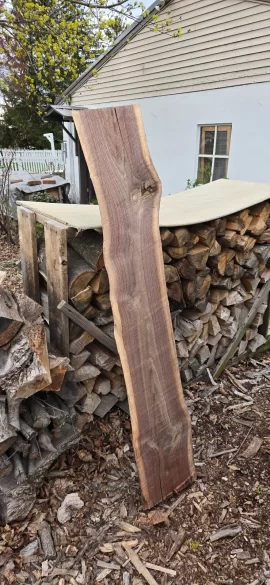

You need a good guide system to get good results. I use a 2x12 with steel angle screwed on and use lumber to screw into the log and fit between the angle iron to hold the board. I have 2x4 and up to 2x10 depending on the height the board needs to be held.

And I like my ladder and boat winch I added after this photo was taken. Use a stretchy cord/rope and it will help you keep consistent forward pressure

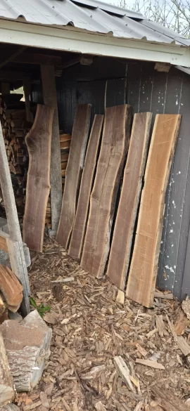

I bought a Haddon lumber maker, a 20" bar and a ripping blade for my Stihl. Glued up some 1 1/2 pieces to make a straight guide and when I make lumber I stand it straight up and bolt it to my woodshed. I then stand up the logs and screw them to the straight edge and just let gravity do the work with the saw. I havn't milled anything over 8 foot at this time. I also sharpen the blade after every cut.
