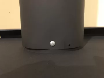

I am not sure about to terminology, I think it is just the outer wall. This is what it looks like.

Oh my god, he crushed the outer wall down trying to secure the pipe to the stove! I’m so sorry for the situation.
It probably won't hurt anything, but it looks bad. I'd make them fix it.
I don't think that's double wall pipe. I think that's single wall that's fastened to the collar like that. If so that's not good! Something is way off there in sizing. Kevin
Gotta be double wall. If it was single wall it would be 8" and you would see the crimped end of it.
Yep the id of the outer pipe on double flue pipe ( the black stuff) is pretty generous. Made that way to fit over every one's flue collar. I will guess there was/is about a 1/2" clearance all around oh the double wall over my collar on the Englander NC30. Crankin a screw down tight at that junction is going to crush the pipe and look awfull.

It also looks pretty awful when the installer drills huge holes in the outer wall to acces to the flue collar for screws. I just didn’t use screws here as directed and approved by professional installers and the inspectors. There’s nothing holding the double wall to my stove.
I used screws to secure our double-wall pipe to the flue collar, without puckering the outer jacket. And I used black screws.
So I loosened the screws and thankfully the outer wall isn't bent. However, it was a long screw and goes through the "inner" wall as well and it makes a small whistling noise if I loosen the screw. Either way I'm going to call my installer and ask him to come make it proper. He was responsive and I am sure he'll agree.
Another question: should the double wall pipe go all the way down to the stove body? As shown in the picture I uploaded, it's about 3/8th of an inch higher than the stove top.
As to the screw color, I plan on painting it black.
The inner liner of the double-wall should fit snugly in the stove's flue collar. The outer jacket may still be a bit higher than the stove top.
Nope, the outer wall will almost always not bottom out on the stove top. The inner wall sets the height as the taper tightens into the stove.
that might vary a bit between stoves and the pipe mfg- previous nc30 od was resting on stove top. pipe was from Selkirk about 8 years ago.
