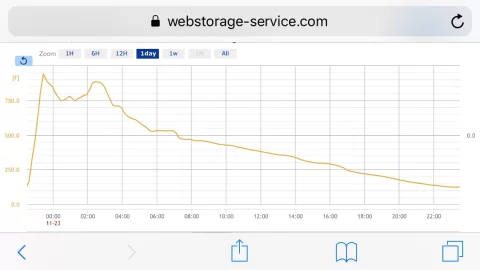

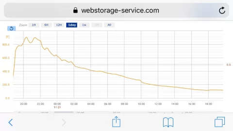

Temps recorded with my new WiFi cat thermometer. Top is N/S bottom is E/W very small difference.

Yes that is correct. Will do some more experimenting maybe I’ll try NE/SW.

Looks like there is a temp variance, and it is a more standard burn with the N/S. Overall, not a huge difference. Granted this is just 1 day of data, i'd like to see more
Also, that thermometer is cool :)
