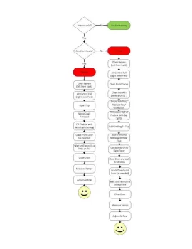

Since there are so many different ways to burn in a stove, and every stove is variable, I have decided that I was going to make a quick reference guide for when visitors come, or when other people besides my wife and I are loading up the stove.
Any feedback is appreciated, but the end goal is to be at the smiley face :)
This is also on the assumption that you are burning things that com-bust decently (good wood).
First you need to start out with the basics figure out if you are cold enough to have a fire, or if there is nothing to worry about:
Once you have gotten the stove aflame, you will want to probably be a little bit more specific about what you are doing and what you are measuring. I did not put the part about arguing if the stove should be hotter or you should take your pants off.

I've not read the entire chart yet but it looks good. Easy to follow and informative for anyone. Good job! ==c

I like your flowcharts! One step missing at the tail end of both flowcharts though.......open a can of frosty cold beer once it gets too hot.

mine is normally at the beginning of the process.... :)

here is the PDF version

I actually really really like this!
You wouldn't happen to have one for a non-cat stove, eh? :)
doesn't that just go something like, put wood in --> burn wood --> put more wood in?

Yes, minimal flowchart needed for non-cat. Light-off to air closed was 15 minutes this morning. The rest was spent enjoying a cuppa joe before a warm fire and a nice light show.

Here's a question I had in creating mine. I currently have chimney fires in the red box from the question of whether the stove is above 700F. In a chimney fire situation, does it really matter what temp the stove is at? Don't have the experience (thankfully) to know.

you could have a chimney fire if the stove is less than that
