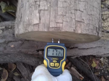

looks like you live within the range of black locust trees...if you can find some that's been down a while (they don't rot easily) usually they don't have any bark left but even if they do if they've been down or standing dead for a while I've moisture tested some at 17% and below immediately after bucking right in the center of the round...
