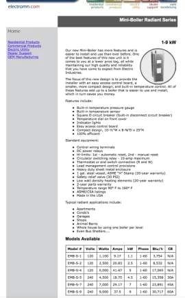

Not sure what these words mean exactly, or implications:
  • Must be installed with a primary secondary (2) pump radiant heat integrator panel installation as found in Hydro Smart integrator radiant heat integrator panels or warranty is void.
i saw that as well. Maybe a way to sell their whole system when all I think I need is the unit and another expansion tank. I don't care about the warranty.
Thermolec out of Canada or Electro NM out of Minnesota are good boilers. Both have out door reset built into the control and staging of the elements with triac relays.
These are designed to be heating boilers, not electric DHW tankless heaters. Find prices online.
