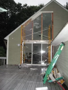

My house is an open concept with vaulted celings. The baseboards in the house were not able to keep up with the heat loss caused by some huge windows that I had. I say had because I removed them this summer and replaced them with a nice insulated wall and some new Marvin windows and a new slider. I suspect that most of my heat was going out those windows. This winter will be the test. My furnace is 2 years old so the technology is good.
It is very hard to determine where and how you are loosing heat.
Here is a photo of what I was dealing with. Last winter I covered them with plastic.
  • [Hearth.com] Not Worth it???

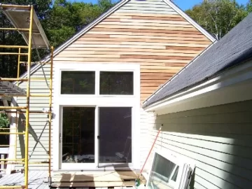

And this is what I ended up with. Still not finished but I suspect much more heat friendly!
