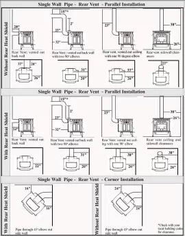

I don't see this option in the Oakwood spec sheet.
Thank you!
Sharii
You can access the actual user manual online at Harman - I suggest you check out all the specs and clearances there before proceeding - good luck, and hope you find one!
PS - Do you have access to truly seasoned wood if you plan to burn this winter?
The clearances are around page 13 of the manual.
I have also attached it.
