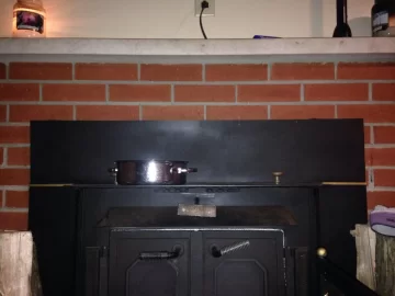

Can you post a pic and show what's hot? Was it installed by a professional? I have a free standing stove and am not familiar with inserts but I'm thinking maybe it's the surround that's hot?

No. Was just a little while ago. Went back out and now it's gone. I'm posting a picture of the hot part.

The first half showing bricks are hot. Don't want to keep my finger in them long. The ones above ( the first full brick) are got also but if I had to I could keep my finger on them for a couple of seconds. The third set above I can keeps hand on for ten seconds or so

Yes it was installed professionally and I had my chimney swept and inspected a month ago. They may just get this hot and I'm just not used to it because I have never had one before and I just want to make SURE my family and I can enjoy it safely
Since your stove is enclosed, I would take a temp right above the hood and shoot for about 600F, tops.
On the brick? And I was going to get a magnetic thermometer tomorrow to out on the door. Don't really know what to buy. But the 600 degree above the hood is some VERY useful info for me. Thank you. Now where is Just above the hood exactly? Lol. Sorry.
Above the metal hood that's over the doors. That's the hottest spot on the front of my buck where I can fit a thermometer.
My big Jotul F600 sits right in front of my fireplace opening with the back six inches of the stove inside the firebox. I just shot the bottom rows of bricks on my chimney above the stove and got a 188 degree reading. Three rows up it's reading 160F. I used to have an insert similar to yours in this fireplace before I replaced it with this stove last February. I used to keep my magnetic thermometer on front of the insert in the area about where your little hood is sitting. On your insert I would put it just above the hood. I used to get readings sometimes as high as 800F, but that was hot and I tried to burn it more in the 400F - 500F range.
Bricks getting that hot would concern me....what are the clearance specs ?...may need a heatshield to protect any combustables.....plastic smell ?....I do get a chemical type smell, I figure it's gotta be the wood, and don't worry about it too much
Thanks everyone for responding. I'm sorry I didn't see the responses til today. I am burning mostly ash wood. I just got the magnetic thermometer and put it just above the lip of the stove. It's not running very hot at all at the moment but I am thinking either I overreacted to a normal type heat or the thermometer isn't working properly. I can put my finger on where I placed the thermometer for a couple seconds and it's reading around 100 degrees. Does this sound right? The fire is almost out at the moment.
