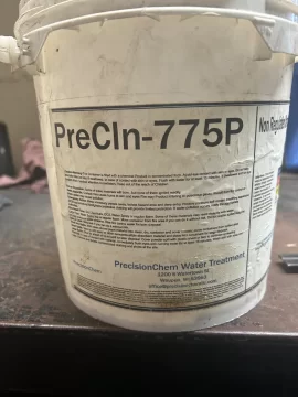

3) what is the best product to use to FLUSH the system to get rid of hard water build up and/or rust? Do you use the same treatment product to leave in the boiler as you do to flush the lines? Even though my Tarm was pressurized, I don’t think it was cleaned properly when it was installed, so on some of the clear piping along the lines you can see that it’s completely rusty.
