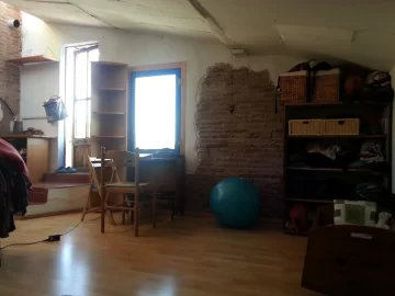

I've included a picture of our room. The big blue ball represents the stove and up in the left corner you can see the old single 120mm pipe which goes straight through the wall at around a 45degree angle. the old chimney was connected straight to this pipe on either side of the wall.
I'm imagining that if I used double walled pipe the heat transfer will be a lot less and thus running the pipe through the room might not make that much sense. Is that correct or will I still be gaining something substaniable with the pipe going up to the top of the wall as it does now?
Even if the heat transfer is not that much I'm still pretty hesitant to put a hole in the roof as It's an old tile roof and I'm afraid I won't be able to get it waterproof again.
I'm curious to hear your thoughts on this interesting puzzle and very much appreciate the input I'm getting from all sides. :-)

Thanks, that helps us visualize the issue much better. This doesn't look like a great setup. It would be much better if the stove could be installed to the left of the door, right below the flue connection.
Where does that 120mm pipe go to? Is it definitely 120 and not 150 mm?

Not ideal because the pipe would be too close to the roof or because the length of 45 degree rise is to long?
Placing the stove to the left of the door is something we hadn't considered before and were looking at this space as a little kitchenet area.
But hey things can always open to change if they have to
The current pipe is 120mm and just traverses the wall (+/- 17cm thick) and sticks out about 20cm on the other side. It is from the last stove used here by another person.
I'd planned to take it out make the whole larger slide in a 150mm pipe and cement it into place.
let me know what you suggest....
The long angled interior run and closeness to the ceiling are both areas of concern. Relocating the stove to right under the new 150mm pipe exit would not only perform better, it would be safer as long as there is room for the stove there. It may take reorganizing the space, but it sounds like you are up to the creative challenge.
