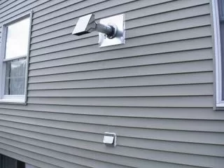

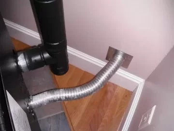

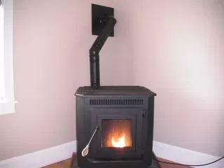

Hi Godzilla,
Here are some pics that might help. The measurements from wall to corners of my stove are 6 inches. Vent pipe to wall is 5 inches.
  • OAK For A Corner Installation
Thanks Sydney. That was VERY helpful. I'm trying to envision how to do this. I don't want to make the hearth too big and I don't want to make it too small. I don't know anyone who has a corner installation. You are the first. I'm trying to get a visual. If you didn't have the OAK on there,you would have been 2 inches from the edges. Now with the OAK on there,how far towards the middle of the room did it get pushed back ?
