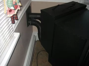

this is the type that has an outlet built into a thimble for exhaust and OAK.
