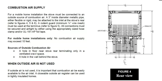

whats a OAK???
Outside Air Kit. It draws outside air for combustion so it doesn't pull the warm air from inside and blow it out causing cold air to sneak in from every nook and cranny. It prevents negative air pressure in your home.
Reactions: SmokeyTheBear
Naahhhhhhhhhhhhhhh, ya don't need one, I went 4 years without one ..................
Wow , Thank you.... Have to look into that..
From your stoves manual:
[Hearth.com] OAK Rocks
LOL ,IM 6 YRS WITHOUT 1 !
I went many years without a pellet stove.... Doesn't mean I didn't need one, just meant I didn't know what I was missing until I had one.
