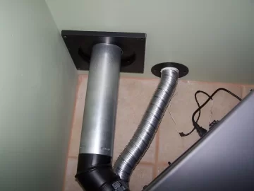

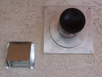

I was in exactly the same situation two weeks ago, didn't even have room to use the larger thimble with built in oak. Cannot say exactly how this is going to work, but here is a quote from the Harman install manual:
The pipe should be run outside and terminate to the side or below the vent pipe outlet so the flue outlet is more than 12" from the inlet cover.
Hers is a couple photos of my install, hope it helps you.
[Hearth.com] OAK with straight out ventilation [Hearth.com] OAK with straight out ventilation
