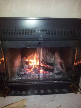

Here is the front view of the fire place...

What is your flue setup? For chimney pipe vertical runs, the bottom of each section of pipe must fit inside of the section below it. The top section is male, that below it is female at each union. This is so any creosote running down inside the flue pipes stays contained inside the pipe. Perhaps one of your unions is bass-ackwards, letting creosote leak on your firebox. Did your sweep check for that? Burning gas (logs) would not reveal such a reversed union, because gas doesn't make creosote.

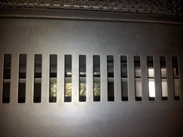

Here is the close up of the top vent. You'll see the shiny aluminum chimney vent (or whatever it's officially called) called on the right. You'll also see a thin piece of sheet metal lifted about 2 to 3 inches above the firebox. I needed to clean this as well as it too had the thin coat of "tar". And the foil insulating around the outside of the box can sort of be seen...

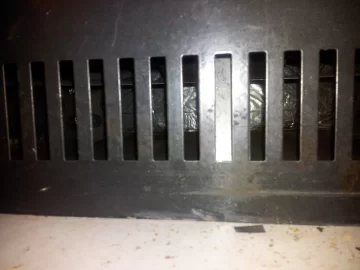

Here is a close up of the bottom vent. Again you can see the foil insulation in the back. Also it too has a piece of sheet metal that is connected to the bottom of the firebox...almost like a hanging bridge. It needed to be cleaned on the top side as well. I have no idea how something would have leaked on it as it's completely under the bottom of the box...

Thin even coating doesn't sound like creosote leaking. The firebox looks fairly clean. Burnt popcorn/beans may not be a good description, a very chemical smell (fumes?).

Creosote will get all over and it does stink bad. If you have it in the stove, you also have it in the chimney and probably worse there.
