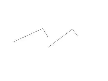

I found mine with a couple pieces of 4"x12"coat hanger shaped like these,
used as dowsing rods. I knew the rough location.
