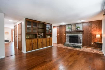

My daughter is considering this house. Looked at it this afternoon.
It's in CT, USA.
Built in 1977. Current heat set up is electric. Very open floor plan on 1st floor, nice stairway leading up to second floor. Note the carport outside the exterior FP brick.
Thoughts?

The odds look fairly good to me but for some reason I couldn't zoom in on those pics
Reactions: Dix
Looks like a masonry FP from the pics.
Reactions: Dix
I can't zoom in either, lifted them from Zillow ;)
I'm going to ask her to take a pic of the interior of the FP, and the flue / chimney. And get dimensions.
Thank you both for confirming my initial thoughts.

Anyway, sure looks like that would be a masonry fireplace. If not, they went to a lot of expense...masonry inside and out... to hide a prefab box.
Around here, they were still building masonry into the late 70's, but then the pre-fab fireplaces really took off in the mid 80's. Possibly similar in your area, too.
The only thing I would caution... 1970's "original equipment" is going on 40+ years old, so might be coming up for re-pointing / re-capping time. (Don't ask me how I know this... said the owner of a 1973 ranch house with full masonry chimney)
I would estimate the length of liner needed at right around 20'. But it looks like there is efflorescence on the straight side of the chimney which I assume is where the liner for the furnace is. That tells me she will most likely need a furnace liner as well. Or if Nat gas is available switching to a condensing furnace that can be vented with plastic may be a better option.

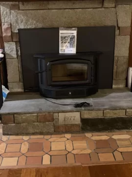

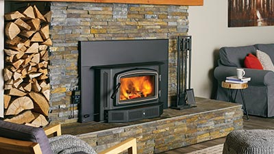

Just an update for youse guys.
This is going in 10/29.
[Hearth.com] Odds On This Being A Masonary FP?
She found 2 reliable firewood guys, and has 3- 4 cord already to go. And more coming in. I set her up with a 4' round rack, ash bucket & shovel, stove tools, and just sent her a 36 count of Super Cedars ;) :cool:

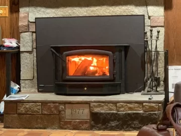

It has arrived !!! Just in time, too !!!. She's already done 2 break in fires ;) :cool:
[Hearth.com] Odds On This Being A Masonary FP?[Hearth.com] Odds On This Being A Masonary FP?[Hearth.com] Odds On This Being A Masonary FP?[Hearth.com] Odds On This Being A Masonary FP?
