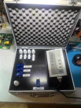

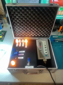

Well after being retired I found time to build a new TOY! It works off of 120vac and works with most 10 pin control boards. Parts on order for 10 pin to what ever I need pigtails to complete it. Let’s me test repairs and test client boards before replacing. Pondering a patent but not sure it’s worth the time and $$$
