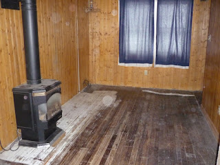

This is our old DV (excuse the bit of a mess, this is our old house after we started doing some demo to get it rental ready). The pipe on the stove terminates into a thimble on the other side of the wall

We had a boatload of work to do out here when we bought the place. Had the 1750 installed then started thinking...what if we are away during the day and something happens so we can't get home? Can't let the dog or pipes freeze, but there's no furnace to back up the stove. Money being tight from all the other work, we picked up the VF and a 100lb LP tank as backup. Eventually I would like to replace it, but it's not a primary or really, even secondary heat source. It will kick on if it's in the teens or single digits or we screw up a stove loading and it drops down to the 50's in the house. This is an old cottage so it's not very air tight in here. But yeah, the reason I can't quite let go of the idea of the Thelin is because I want it to go live where the VF is one day. DH has no big issue with the VF so it wouldn't be until that dies. THEN there's what we'd put in the Bunkie...and we couldn't use the same set up for a wood stove and since we have a ceiling and attic in the house and not the bunkie, the B-Vent piping wouldn't all be used in the house either.
