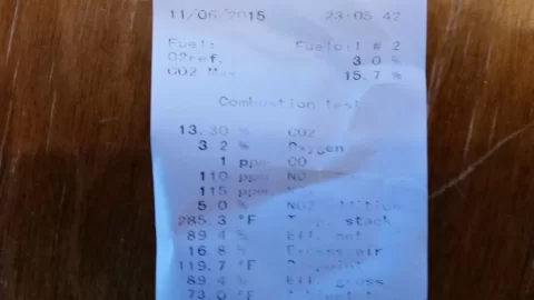

I have been tuning my 3 year old Carrier forced air oil furnace myself for the past 3 years. When I bought the house 3 years ago it was brand new and was tuned like crap. Wrong nozzle, pump pressure way off, air setting, etc.. With a lot of stuff these days if you want it done right do it yourself. Not saying all techs are bad but the majority probably just slap a nozzle and filter in and leave.
All I did was read the installation manual and the Beckett Oil burner guide and tuned it myself.
It takes all of about an hour and I am lucky that my cousin is an HVAC tech and lets me use his Testo combustion analyzer.
I just tuned mine last week and at the factory recommended settings I just had to increase the air just a slight bit after checking it with the analyzer and doing a smoke test.
The big player here is having a combustion analyzer. If I didn't have access to one I would probably just buy one. After a few tune ups it would pay for itself for the peace of mind knowing it was done right. I think the going rate around here is $150+
Here is the printout from when I tuned it last week. 89 percent efficiency according to the printout.
