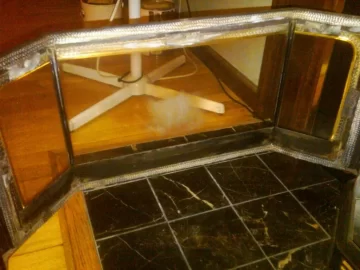

here isa photo of my glass door. i am tryingot solve this airwash problem. do I shim the bottom plate away from the glass? ere does the air come in from, under the bottom of the glass through the door? in other words is that why no gasket on the bottom, so the air can be sucked into the chamber fromthe bottom & up the glass?
my soot starts from the top & covers the entire glass in 1.5 days.
