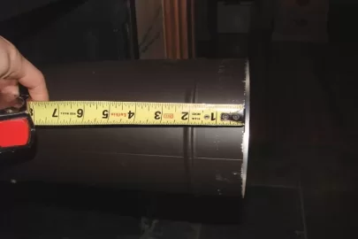

I'm ever so close to finishing the install of my Fireview; the only issue left is that the pipe between the Tee and the stove is about 3 inches too long. Is it OK to just cut the front end (the one that goes into the back of the stove) off?
There is a raised lip about two inches from the end, which would seem to be there to prevent the pipe going too far into the stove, but the pipe only went about 1 inch into the stove anyway. I'm pretty sure the diameter behind the lip is the same as the diameter in front of it. Is there any reason I can't cut it off behind the lip?

I'm doing the same thing - I thought the other end (crimped) goes into your stove, while the non-crimped end goes to the next piece of (crimped) stove pipe...
If you have a crimped end, then, yes, that's the end that goes into the stove. The one that comes off my tee has a crimped end pointing toward the stove, but this piece of pipe is different. Neither end is crimped. The end you see is the smaller end, but it seems the overall dimension of the pipe is what the dimension of the crimped end would be. Am I making sense?
You can cut that end.
I use a circular saw with a thin abrasive cut-off blade.
Draw a line all the way around it with a Sharpie marker,
or wrap a piece of masking tape around it as a guide...
If you have a friend hold it securely, he can roll it as you cut..
You'll get a fairly nice cut - depending on your eye...
Speaking of eyes - WEAR SAFETY GLASSES!
Deburr it with a smooth file & you're good to go.

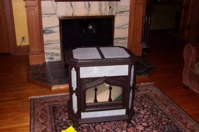

Just look at that Fireview waiting there.

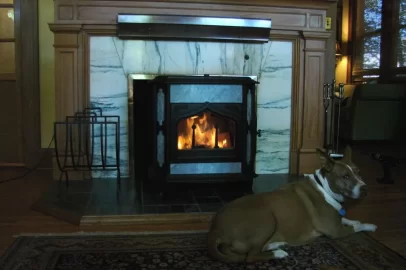

I can settle this argument with dispatch. I cut three inches off a little while ago, and shortly thereafter, my Fireview achieved secondary burn. 'Nough said? ; )
Really it is confusing, though, only because with most pipe, the diamater of the whole pipe IS the diameter of the female end. That's the way the nose pipe coming off the tee is. You'd have to crimp it to make it male. But with the extension pipe I got from woodstock, it's just the opposite; the overall pipe is the same dimension is the male end, whereas the female end has, as someone called it a bell (i.e., it widens out.)
Anyway, thanks for the help everyone. The fireview is cranking now, and my house stinks.
