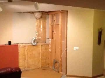

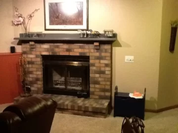

Turns out he did the same thing I am doing, pulling out a contractor ZC fireplace and putting in a stove.
He showed me how he left the outer piece of chimney and ran the class A up the middle.
I pulled the stove today and the inner pipe from the double wall installation. I secured the outer wall (12.5) inch with some Bolts throught the framing in the ceiling before cutting the support straps loose.
I intend on doing the same thing and running the class A inside the 12.5 inch tube running up the chase.
Is looks like I will be able to use old cap and flashing when I install the new inner pipe. The old inner was 8 inch OD just like the double wall class A.
Now the questions:
This installation is going to require a pair of 45s in the stove pipe to get it to the ceiling.
The class A is supposed to stick through an inch or two before the fitting to attach the stove pipe.
I will have 9 inches clearance from the outside of the 45 at the top where it enters the class A stub and the studs for the side wall I intend to Durock and stone. I can't find any requirements for this distance in the Woodstock instructions. Is 9 inches enough? The stove pipe clearance gets greater as it goes down in the 45 so there will only be a run of 2 inches of stove pipe that close to the wall.
I would like to put a tee in at the back of the stove with a cap on the bottom for cleaning. I was told the Woodstock sells these, I can't find them onthe website. Do I need to call for pricing?
Lastly, I have an outside combustion air tube sitting there from the old ZC fireplace. The guy I bought the stove from did too. He got the outside air kit from Woodstock and hooked it up. Do you guys think it makes any difference in overall efficiency of this type of install?
Couple pics of so far.....
Do you have double wall stove pipe? That has a clearance to combustibles of only 6 inches. Single wall needs 18 inches.
As far as the T goes buy the same exact brand as the rest of the stove pipe and just do a google search to find dealers that carry it or sell it online.
There is a debate about outside air kits but most agree it is a good thing. The idea is that pulling outside air in for combustion keeps the stove from drawing room air. Drawing room air creates a low pressure zone sucking cold air into your house from outside making the edges of your house chilly.
The Woodstock brand pipe he is giving me is single wall. I would like to use single as it should radiate heat hence the clearance discussion. I see they make 45s and 30s in the class A, maybe a piece of that through the ceiling angling towards the stove then down to the single?
The original double wall with 12.5 OD and 8 inch inside had the space between open at the top and bottom.
Now the outer pipe will terminate just above or at the Durock ceiling with a close out to the double wall Class A.
At the top I am planning the same with some cone shaped flashing to keep rain and bugs out.
So the next question, there is a fire stop square flange inside the chase where the 12.5 inch pipe goes through the upper ceiling into the attic. There is a 1/4 inch gap around the pipe and the hole in the flange, can I seal this since the Class A could be running up by itself.
The main reason I want to use the old 12 inch is hopefully keep the inner pipe warmer than it would be if it was just in an uninsulated chase. I have read where Class A doesn't draft well when mounted outside running up the side of the house. Plus I can leave all the flashing and screened cap in place where it exits the chase on top.
It has to be a little safer too.
I just need to figure out the clearance to the wall where I go into the ceiling.
Dan
