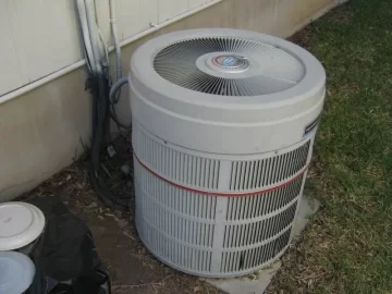

I'm putting an offer in on a house today and assuming all goes well we'll be going forward with inspections, etc...soon. Home is just over 2,000 SF, built in 1972 and has a heat pump. I've honestly never seen one in a house in NJ-I thought they were only really used in more moderate to warm climates? Anyway, it looks to be original to the home. The outside unit looks like this:

It may be younger than 35 yrs old. Get the model number and do some research on its specs, age and efficiency. In NJ this could work nice for shoulder season heating when outside temps are 45-50F and above even if it's an older unit. For the Englander install, check for flue location relative to the furnace location. You'll want to tie into the trunk duct close to the furnace.
Ask for a copy of the electric bill the last two winters. That may tell you a lot.
