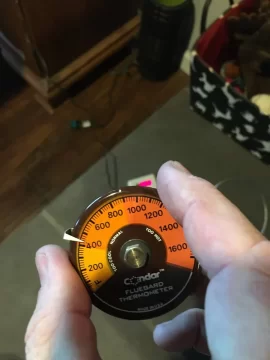

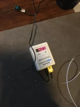

I heard this funny rumor that bimetallic probe meters fail after a few thousand hours. Mine has been in service for like 15 years and we have an 8-9 month burn season. I picked up a digital probe meter for the shop single wall pipe stove but thought I would check the accuracy of the well used but perfect looking condar in my house stove. This is in the flue of my BK that has been cruising along for about 8 hours at a thermostatically controlled constant output level.
I confirm that the condar is still accurate even if it is slower to react than a digital meter. I reject the theory that these meters die of old age and plan to keep using it until it stops working.

I have seen plenty of old ones that seem to work fine still. But I also see them reading 100 or 150 on a cold pipe
I'll keep an eye out for that as an indicator of failure. I know you can adjust them to rezero the dial but if that is necessary then something has changed.
From what i see, your condar reads a bit high......haha.
I will do the same test tomorrow on my VC probe meter. On a side note, my old VC magnetic griddle top meter (never look at it anymore) reads very close to 70 on cold stove but it is exponentially off at 500 i.e. magnetic read 650-700 but IR gun says 500
I suspect yours may have been more accurate than ours. IIRC you were consistently seeing very high flue temps on the Heritage which I could not repro. Ours reads about 75 at room temp, but is consistently 100-150º low and is about the same vintage as yours.
There is always this other possibility that the error will grow as the temperatures rise. This is just one data point on the scale but arguably the most important one for my application since it helps me avoid creosote condensation and also tells me when to engage the catalyst.
This condar saw 1250 pretty often when it was above a hearthstone at full chooch.
Thank you @Highbeam i just stuck the cat probe that is attached to my auber at100 into the flue probe hole. The Imperial flue probe read 200 and when i put the at100 probe it read 293. I have a feeling that my Imperial probe in my BK might be off too. I believe a condar flue guard is in order.
Whoa that’s a big error. These k type thermocouples should be the proper tool to check on the accuracy of other probe meters.
I thought about pulling out my cat meter, also a condar, and dropping the thermocouple in that hole but it was registering 1300 degrees and my bare fingers aren’t up to that.
I did that last year. I had a spare meter from Alibaba that i bought for 3.99. It read C* only. My probe was 6” long so I attached a bear clip to it. As the probe got hot the clip kept coming off. The two readings i did get, both were lower than the manual probe. Over Christmas i will be spending more time with the BK and i will bring the at100 with me. Will try to hook it up to the stovetop hole and will report on the readings. I believe someone else here is already using at100 on the BK.

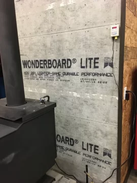

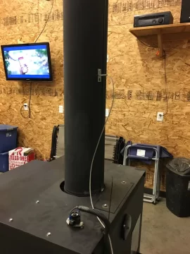

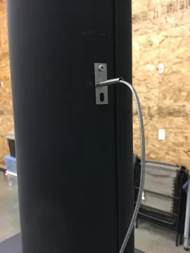

This one was meant for the nc30. Couldn’t wait to install it. Used a 1/8” drill bit which was plenty large.
This thing is lots of fun. Open the door to throw in an oily rag and the meter drops 50degrees. Very fast. The factory alarm goes off at just 500 so I’ll need to fix that.

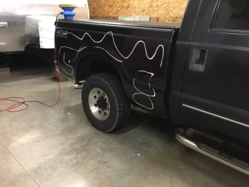

While I was installing this meter tonight I was waxing the f350 which I installed a pyrometer into the exhaust manifold years ago. As near as I can tell it’s the exact same thing.
So do you think this probe will get carboned up and be impossible to remove from the pipe?[Hearth.com] Old condar probe meter vs. new auber digital thermocouple
I don't think so. It's never been an issue to pull out the Condar probe.
