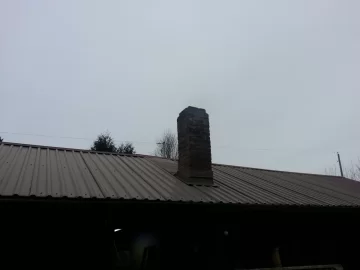

have this old pacific energy stove i just plugged into a old brick chimney in a shop. It is smokey when i am burning wood, i don't know anything about it.
There is two big plates up top like a secondary burn place but the gaps for the smoke to go up are on the sides and there is a little hole on each plate up front. Is this stove missing some pieces up top does anyone know or is it just not they less smokey pollution type ? can it be altered ?
I also don't know why there is two different control knobs on it as one is warn off i can't read them.
The chimney and pipes are leaking bit of air at some gaps i would like to fix.
Also how do you clean the air intake passages on this type of stove on or is there anything else that can be improved about it ?
thanks !

What is the size and height of the chimney? What size is the outlet on the stove? How dry is the wood you are using?

What size liners are in the chimney? Is that a barometric damper in the pipe?
I see a few issues off the bat the chimney looks pretty short that will reduce your draft. the hard 90 degree elbow will reduce it more. The reduction in pipe size will hurt it even more. You have allot of things working against you at this point.

There is no liner in the chimney at all just the brick
Yes, on top of what you said i also have a bit of mortar brick joints near the floor that have some gaps. I will be improving some of that system like the 90 degree elbow.

How are you testing that? 10% is impossible drying by air in most of north america.

You really really need a liner of some sort. Especially if the mortar is failing as you say.

I personally would not recommend burning it without any liner at all and failing mortar
I'm suspicious that this may not be a Pacific Energy stove. Are there any labels or made in Canada markings? The setup has lots of issues with the flue system. bholler is right and the safety concerns he pointed out are quite valid. This chimney needs a liner.
What is the flue collar diameter? What is the interior dimension of the chimney?
