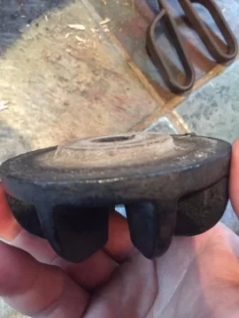

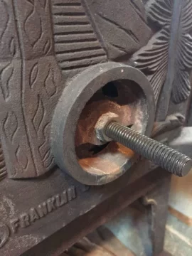

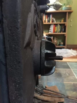

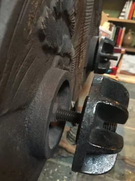

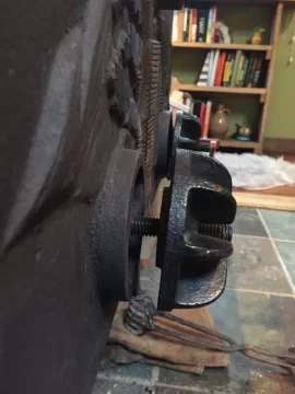

I think you are on to something with the nut preventing the damper from closing flush with the stove body. I don’t have a flu damper unfortunately. Here are a few pics I took. You can see the dampers not closing flush and the nut that is preventing them from doing so. I’m thinking I either need a smaller nut or that I don’t have the proper draft caps.

You could make your own draft caps out of a pipe cap that has been drilled and tapped, but I would try the flue damper first. It's inexpensive and will help slow down the flue gases giving them more residence time in the stove which should help it heat better.
They are the correct draft caps.
The nut looks like a "half nut" but pictures can fool you by depth of things. A half nut is about half the thickness of a regular nut. They are for locking purposes such as used in your case to lock the threads from turning in the door. The way to see if the cap is bottoming out on the nut is to put a straight edge across the opening on door where the cap should touch. Measure distance from straight edge to nut. Then flip draft cap over with inside upwards and put the straight edge across draft cap. Measure the distance from straight edge to portion on cap that seals against door. If the depth of raised section on cap is more than the distance from door sealing edge to nut, cap is hitting the nut before contacting the door. Remove the nut and try it. If needed, grind or file the nut thinner. The nut only needs to be 2 or 3 threads thick since it is not a strength issue.
I would not file any material off the cap since those are the threads that wear and you want the most threads in the cap as you can get. That is why you must keep the threads greased to prevent wearing out threads to prevent cap wobble.
