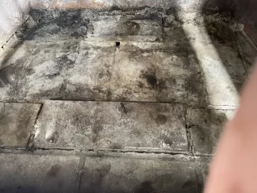

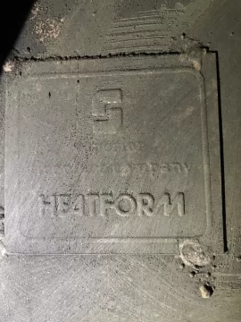

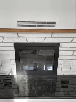

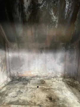

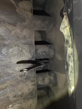

Yes, fair point. I’m not entirely sure how to figure out what fireplace model this is. I haven’t been able to find anything in there with a serial number so not sure if these pictures will prove much help.
The fireplace door that’s on there now has to remain open when a fire is going but if this type of fireplace requires a closed door, I’ll have to look into getting new ceramic doors that can withstand the heat.

Ok that is just a heat form with a set of doors added. The glass is probably just tempered glass which won't handle rapid heat changes. Most times if you close them at the start of the fire and keep them closed it will be fine. But closing them on a hot fire or opening them when hot will crack them. But without having the manual for the doors it's just a guess. Either way it will never be an efficient heater.

It will provide some heat to the room both radiantly and convectively thru the heat exchange tubes on top. You can safely run it without the blower(s) running, but at a lower heat output. Close the doors as the coals die down to reduce room air being sucked up the chimney as things cool down.
