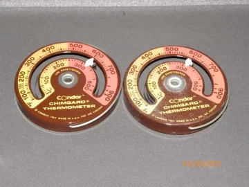

I stopped by our local hearth shop to pick up a new Chimgard Thermometer for the stove top. I wanted to see if there was a difference in the temp readings. The old thermometer is on the left and the new on the right, the new one has been on only one hour with a big difference in the temp readings.

Could not let this go tonight so i went downstairs to fill the old beast for the night. Took the three thermometers and placed them within proximity of each other:
Results:
Condar- 600
Old Rutland-620
New Rutland- 750
Still going to get the IR, but feeling a little more comfortable with where the stove is running now. Seems the new Rutland tends to "take off" when the stove hits 500 or so whereas the other two continued on a more expected rise pattern.

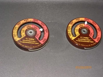

Tonight I have the new thermometer on the left with some cherry splits going, attached are some pictures. Temps are stove top temps.

Huh. So it had a learning curve?

Well, my new Rutland was just the opposite- took off like an SOB compared to my other thermometers. Guess I just got the hyperactive spring on that one- kind of like my personality.
I think there is a slight difference in mechanics with the thermos.
A rutland has a needle that is centrally pivoted. The other "more accurate ones" (so i hear) use the bi-metallic material as the needle. There must be a mechanical advantage to tahat over trying to transfer the energy to a needle. of course this has to be minimal at best, they do function slighty different.
They look pretty close now Zap - how old was the first one? I had replaced mine at one point and did notice a difference (100 degrees) but that Condar was almost 10 years old, so I guess I don't expect the little bimetallic metal coil to be accurate forever. I also notice a big difference in temp just a couple inches apart, but my IR and two Condars are all within about 30 degrees of each other. I just leave one on the stovetop and occasionally compare between or rotate them. I sort of view gauge replacement now like changing batteries in a smoke detector - it's something that just needs to be done. I'm going to keep doing it every other season, which might be overkill, but I like overkill. Plus it's always fun to go take a peek at the stove shop! :)

The old one was bought in May 2009 just after we had the Liberty installed.
Zap
That's why I said reverse positions of the thermometers. The stove top is not even temperatured all across the top. Find a location that is average and put the thermometer there. These are not precision instruments.
