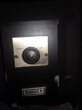

My wife and I bought an old farm house last March, it came with a old woodstove it' says Ranger on it haven't been able to ANY information on it. Someone said they are now called Acorn stoves not sure if that's true or not. It's old but it does have a fan on it on the back Low, high and auto and on the front. It does NOT have a damper on it, it does have a vent on the front of it with a dial that says low and high on the front of it. While there is no fan I'm assuming that it's a air vent that brings air into the stove. The stove won't burn all night IF we get two hours we count ourselves lucky. We seem to get the best burn time with the door open and not running the fan. We plan to replace it at some point but for now we have other things to get done it's VERY cold this winter as much as the East coast is. So without having to use the base board heaters or the electric heaters and jacking up the electric bill, this is our means of efficient heat.

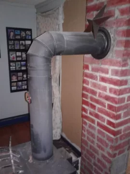

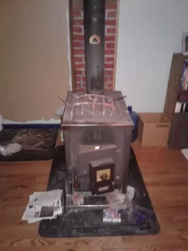

Just going off the information that I have. Here are the pictures finally had time to load them up.
The switch on the back say Low, high and auto. He have took the grate out and it burns MUCH better and hotter. Does burn longer too but it's not very efficient.

It will never be very efficient. Stove design has improved a lot in that area.
I am 30 miles west of Asheville, in Marshall.
That is an old, old stove. An oldie but not a goodie.
Wood stoves have improved a great deal since that thing was built. Also your install is suspect, going into that masonry flue.
You need to get somebody good out there to inspect the pipe and make sure it is a safe install.
You need to seriously consider getting a new stove. You can go over to the main wood stove forum and post the size house, size of the room etc and get recommendations for the new stove.
