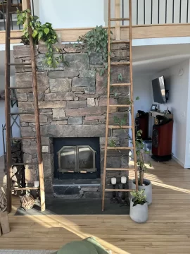

hey everyone.
I moved into a house with a Bis 1 wood burning stove. It's ~25 years old but was supposed to be pretty efficient. It doesn't give off a lot of heat :( I was wondering if there was something I could do differently?
there are two vents on the side about 6 feet up where heat is supposed to escape. it does warm a tiny bit but not enough to even nudge the temperature up. and almost no heat comes out the front. dunno where it goes ! :) out the chimney I suppose.
I have tried all kinds of configurations in terms of more wood, allowing more air in, etc.
If I open the doors to the stove, we feel more heat out the front - so I was thinking of getting a screen and just running it with the doors open?
(I got a high level inspection with camera and everything is ok)
thank you for any suggestions with this.

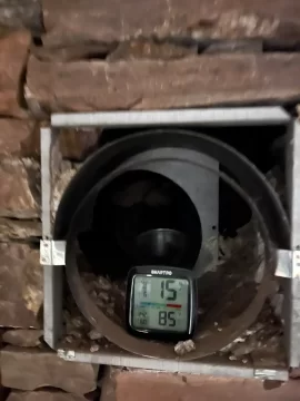

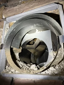

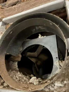

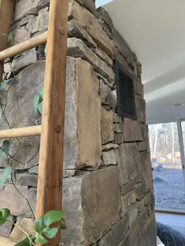

I took the grill off the side vent and I see holes in the duct work.
there's also a ~4" gap between the duct and the vent and I bet a bunch of heat is just going into the cavity there
Good sleuthing. That's pretty sloppy. Is that tar paper in there?
Leave the grille off so that you can access the actual vent duct for the heat check.

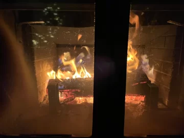

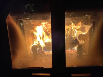

so here is a fire about 30 min after I started it. this is with the slider thing closed completely.
  • [Hearth.com] Minimal Heat coming out of my Fireplace
here is the fire with the slider thing ~1/2 open

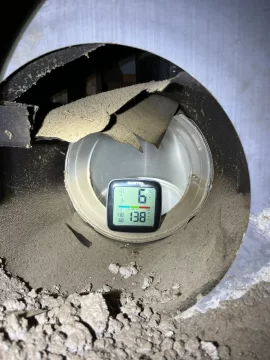

ok so I only have a random room thermometer...I stuck it in the vent where it turns (about 2 feet in) and it got to ~140 degrees in < 1 min. (It was still climbing but I took it out cause i was afraid the thermometer itself melt).
when I move the thermometer back to where the grill would be (after the hole in there) it goes down to like 85 degrees.
so I think a lot of heat is just escaping in that hole

Those tears almost look like tar paper? Are they metal or something else?
For testing purposes you could try covering the holes/tears with aluminum foil and see if that helps the heat travel into the room.

That firewood in the rack by the wall looks like it should be good?
yes it's tar paper that has gotten brittle and just torn. they didn't run the vent ducting all the way to the grill.
I felt the wall upstairs and the wall is warm. all the heat is just going into that cavity.
I for sure am losing >50 degrees of heat from where the vent bends to the grill.
Is the heat still going to inside the house, but just from a different location or being used to warm the stone?
Since it's tar paper, i'd definitely try tinfoil or something similar to close that gap and see what happens.
I think so. I am obviously a newbie but the wood was outside for years and I brought it inside my dry house for > a month now. it was on the ground but I took from the top of the pile. it feels rather dry.

I think that hole in the venting is the main culprit

no it's all going just inside this cavity made of sheetrock. this is a pic from the manual. the vent ends...then there is that broken tar paper...then another 4 inch gap with nothing...then a grill covering it all.
then I felt this wall...and the wall is warm. it's just all going in there
