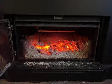

I cleaned all ash out completely Tuesday afternoon. Here is how much ash has built up since then. This was taken this morning. Again burning straight oak. Its almost already due for a clean out again.
  • [Hearth.com] BK Sirocco 25 Help Please
This is related to the wood, not the stove.
Some wood species make more ash than others. And within the same species it'll depend on where it grew, and e.g. whether bark was on the pieces or not.
If I burn straight red oak, I can go about a week and a half before (and this is important), I find there's too much ash in there. THe important part is "I find" - because it relates to my OCD of wanting the firebox to be as full with fuel as possible. Therefore I never let it fill the belly to the top of the brick.
Your insert may have a shallower belly (depth), leading to it filling up quicker - not sure.
But it's not the stove. Ashes are mostly noncombustible left-overs. No stove can burn (and thus make into exhaust gases) things that are not combustibe.
Completely normal for hardwoods. The higher the specific gravity of a species, more cooling properties. If you can, switch to softwood for a day or two and you'll see the difference.

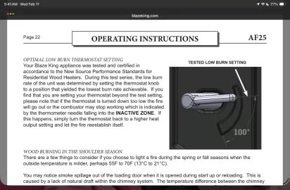

The above screenshot is from BK’s online owners manual Ashford Insert. When the CAT stalls where about is your thermostat dial? To my understanding any setting above the 2:30-3:00 o’clock(as shown) could/might/maybe cause the stove to stall.
I have a BK Princess freestanding stove, when I run a window fan behind the stove I get a higher burn rate. I’m pulling hot air away from the stove thus “fooling” the thermostat into thinking the room is colder than it really is.
Reactions: GG Woody
It should be noted (as posted numerous times) the combustor thermometer on certain units use a "switch" and others use a bimetallic spring. The AF25 & SC25 both have switch type of thermometer. Once the combustor hits 550F, the needle moves to the right, arond 12-1, referencing a clock. When the combustor drops below 550F, the needle move to the left. It is very simple and yet very confusing as most of our units have thermometers that fluctuate during the burn cycle.
Air movement across the stove top of those with the bimetallic, can influence the actual reading as air hits the bimetallic spring. That is why the manual instructs users to turn off the fans for 10 minutes or so to then take a reading.

Thanks. I read previous posts talking about "switch" performance of BK thermostats and was wondering if that applied here (I also missed the part about fan and reading, thanks also for that).
I'm still having trouble reconciling that with what I see on my Ashford 25 insert, though. When I have a new load and I turn down thermostat, I get a good glow on the cat and the thermom sits at 12-1p as you describe (and no higher). As the burn progresses and less cat glow, the needle moves down to sit at the edge of the red zone for an extended time period. And when cold (or late burn/coals) it sits in grey zone (~10 o'clock). All of which is to say that I'm seeing it move between 3 distinct zones, whereas if it were a switch I would expect it to only be in 2 different positions. Am I missing something here?
