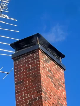

What kind of cap is on your flue?

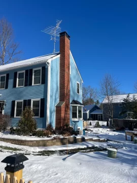

Picture attached for cap, flue is brand new as well. Moisture meter for measuring. Take random pieces from the batch and split in half and check in multiple spots. This wood had delivered fall 2024 and was already seasoned. We had a chimney fire in Jan of this year from a company messing up and reparging over creosote and so everything been redone this fall and all wood is definitely seasoned now.
Wood splits are 2x3 up to 4x6 being used. I pack the fire box and use smaller splits and even smaller to pack it good.

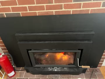

Chimney is 35’ tall based off my install paperwork. Currently no idea how to tighten it up more as currently its better after adjusting latch but not where it should be but hard to open and close door as super tight now.
Pictures attached. Thanks :)

You may need to loosen them back up and start over. If one get tightened too much before the other it can cause that to happen. Dollar bill should have resistance all the way around the door, but still be able to be pulled through. Not too tight not too loose.
That is a really tall chimney. Did they install an insulated flue liner? Look at the stove manual and see what they recommend for the chimney height. Rigid pipe elbows also affect the draft of the chimney.
Yes fully insulated stainless steel liner.

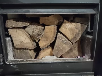

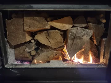

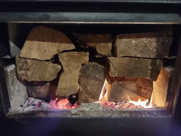

Please post picture of full load.
BKVP

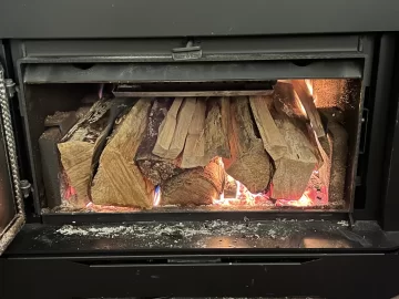

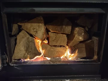

Not sure how deep your belly is (tho it looks to be full of coals also and ashes), but this is what a full load for me looks like.

Not sure how deep your belly is (tho it looks to be full of course also and ashes), but this is what a full load for me looks like.
The inserts appear to have less headroom. What is the length of the splits?
Reactions: stoveliker
Just did a top off for the evening
Two thoughts. To get more fuel into the stove, empty out ashes more frequently.
Second, that is a nice load of small pieces. As someone already suggested, that is a lot of surface area and will combust quickly.
Of course I have a KE40, but each piece is 12"+. Can you get some 12" rounds and split them in half. Then play tetris!

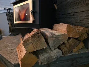

  • [Hearth.com] BK Sirocco 25 Help Please
Big pieces take longer to season but they get you the burn times BK are known for.
I assume that you would need to run that load with the bypass open until the cat is hot, and then with the thermostat on high until it can be turned down to low.
Approximately how long for each phase? Do you look for all of the wood to be bricked (charred outside) before turning down the thermostat? Or it is more related to time and 'sensing' that there's enough heat in the wood and stove to reduce the air flow?
