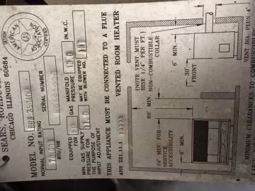

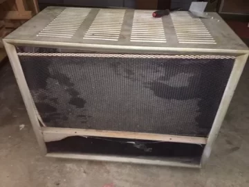

Hi folks - new to the forum was hoping you can assist me in identifying an LP heather I inherited from my grandfather. I have no information on it other than the limited amount i could find on google and the pictures you will find in the attached.Has anyone had any experience with a heater like this one?
What I found out, if accurate, is that it's a Schwank but I cannot find a manual online. https://www.searspartsdirect.com/mo...tml?searchType=manualSearch&searchTerm=359400

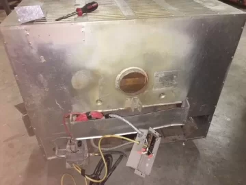

Lastly - there are two wires that connect to the valve that are spooled together (From when gpa disconnected it i am assuming) that i guess would go to a thermostat if anyone knows? And if so, what thermostats are recommended typically?

Are you referring to the coiled red wire? Looks to be coming off a transformer.
I would venture a guess that it is a 24V system, but you will need to test the wires for voltage.
If that is the voltage, then you will need a 24V thermostat.
Thanks Daksy. Yes those are the wires i was referring to. I will test those wires this evening.

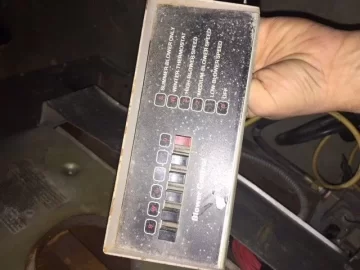

Also - should this unit 'run' without a thermostat do you know? before i bought a thermostat i wanted to make sure it was in good operating order. Is there anyway to accomplish this without a t-stat? Also - anything else i should know or beware of? I plugged it in and pushed the fan button but nothing happened - wasn't sure if it was b/c no pilot light was lit and/or no thermostat hookup.
Thanks again!
If there is a Hi-Lo Regulator on the valve, then I'd say you could run it without the t-stat.
As far as the blower operation, it may be wired similar to the newer units & have a thermodisk
in the system. That will keep the blower from operating until the heat exchanger has reached
a certain temperature. Once that temp is reached, the t-disk will close & actuate the blower.
That system will prevent the blower from moving unheated air.
