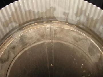

2. Here's the Selkirk "Sure-Temp" chimney adapter. When I spoke to Selkirk, they claimed the Sure-Temp line would be compatible with the older metalbestos pipe. As you see from the photos, it does fit in the recess of the chimney, but the diameter is about 1/16 of an inch too narrow and it won't "lock". I suppose I could get it to lock if I flared out the slots, but not sure I want to go there:

4. Here are some photos of the inside with the adapter seated:
[Hearth.com] Older Metalbestos Pipe Kit[Hearth.com] Older Metalbestos Pipe Kit
5. Here you can see that the adapter does fully seat at least a good inch:
[Hearth.com] Older Metalbestos Pipe Kit [Hearth.com] Older Metalbestos Pipe Kit

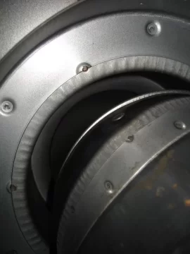

6. Here you can see that the adapter and chimney fully seat in the ceiling support box:
From underneath:
[Hearth.com] Older Metalbestos Pipe Kit [Hearth.com] Older Metalbestos Pipe Kit [Hearth.com] Older Metalbestos Pipe Kit
