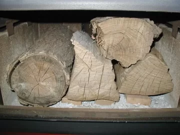

Night loading all depends on how cold it is outside. Pictured below is a sample of home i will load for the night around 20° and lower. Kinda hard to tell how big the slpits are by looking but the bigger splits and rounds will give you longer burn times than a buch of small splits.
The round show is about 7.5" -8" across X 17"-18" long to give you an idea of scale.

Looks good, thanks for the pic of the night burn. Looks like you pretty much stuff 4 big logs in, a little room left in firebox correct. Do you have stove completely closed, I mean do you have it all the way to "L" on your Summit Stove?
The load is just for picture purposes with no caol bed , lots of room for wood and good coal bed and smaller splits can be added if needed. Pictured is not stuffed by no means.
I just noticed you have small pieces of wood underneath the big 4 pieces in your picture Roospike, does that just start the burn quicker?

The blocks of oak shown in the pic i do use to help start a new coal but i would never start this size load from scratch. also smaller pieces to get a coal bed going first.
In the pic i just put some oak blocks down to keep the logs out of the ash to take pictures.
