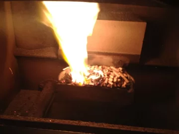

I started in stove temp mode last night. No change. This is moments after ignition

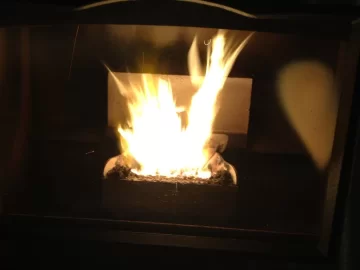

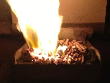

This is a few minutes later. Notice how fire is being squeezed into the corner of the burn pot and over the edge.

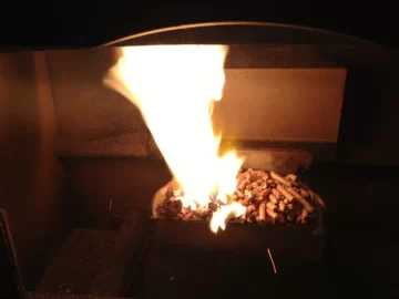

And this is 5 or so minutes later after I intervened and opened the lid to stop the flow of pellets and then closed once a lot of the pellets were burned off. This appears to be normal to me at this point.

My question is this. When heat is detected by the ESP after ignition, I assume it is then the ESP running the show as far as telling the system how many pellets to feed? Or is that handled by some other part in the system? Thanks.
lets say you turn the unit off...you wait for it to shut down, you clean the burnpot, then turn it back on...how long, in rough minutes, does it take to ignite? I ask because if you have delayed ignition, and the stove begins to feed pellets (in theory to attempt ignition again) and then you get ignition, it will most certainly overfeed.
After seeing those pics it looks like your getting a late ignition. I think you said the stove runs well after everything settles? If it does then I am going to move the igniter in as suspect based on the updated info. There are a few easy things you can try. tap the top of the burn pot with the harman cleaning tool to knock off any ash that may be acumulated on the igniter. Take off the igniter access panel and clean the area under the burn pot. Also check that the none of the burnpot holes are clogged. Push a finish nail through the holes to open them up if needed.

Unfortunately, I have been through all those cleaning items previously, and numerous times, since Wednesday. I was a little foggy this morning when I said immediately after ignition. That was actually probably a minute or 2 after. I forgot to take a picture at the exact moment, but it ignited with a small amount (what I deem normal) of pellets with flame roughly 3/4 across the burn pot. Then the auger kicks in and ruins it all. It generally takes something like 5 minutes or less to light. Occasionally, it takes longer, but not recently during this episode.

Ok. So you are getting ignition with a normal amount of pellets in the pot. The auger continues to push new pellets in and what the pictures are showing is the result. If you stop the feed of pellets and let the pellets burn down then restore the auger the stove operates without issue. The ESP is still on the radar screen for me.
